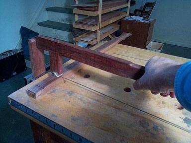

Here is a picture I remember from the MIMF of Dwain Wilder's fret press maybe this could be an easy alternative.
Rod True38803.109525463

PostPosted: Mon Mar 27, 2006 9:07 am
Posts: 908
I must admit, I like the looks of that simple, home made press! Get the leverage ratio correct, and you can get plenty of power with that. Add a hook, and you can press the fret in, and leave it there under pressure while the glue cures, in the case of a problem fret/worn slot.
Must to make.... thanks for posting that photo, Rod!

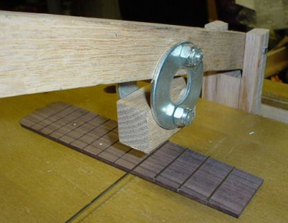

I made my own copy of Dwain Wilder's press and yes, it can develop more than enough pressure. And it has good tactile feedback when the fret seats. I'm not sure how the business end of Dwain's press is built. I made mine so the caul pivots and aligns with the fretboard, so that it bears evenly across the width of the fretboard.

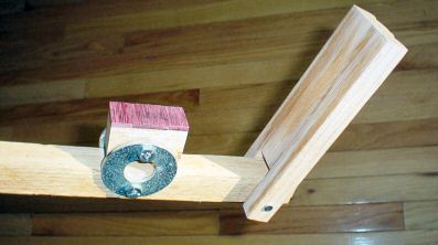

I made the fret press kind of on impulse one day so I just used what I had laying around. I used some left over oak flooring for the wood and some heavy washers to hold the 'caul'. The tops of the frets can leave an impression in the wood caul, which is fine if you can hit the same spot everytime. I didn't and ended up with an irregular surface on the oak block, so I added some hard purpleheart scraps, with the grain running 90 degrees to the frets, and this has held up well.
Note that with my press, you do not want the washers to pivot on the top bolt. The nut on the top bolt is tight so that the washers are clamped against the handle. The lower bolt is tightened just enough so that the caul block does not flop around, but easily aligns to the fret surface.
The handle is 30" long, and the caul is 4" from the handle pivot, so the lever ratio is 7.5:1.
So far I have only used this for flat (non-radiused) fretboards. I did buy some of the S-M brass fret caul inserts for radiused boards. When I need to use them I'll make a block with a groove to hold the inserts.
I have a plan to build a more "thought out" version of this press. I would use side plates that fasten or clamp rigidly to the handle instead of the washers. They could be made so that you can change the position along the handle, to adjust the leverage, but I doubt it's worth the effort. The caul block might be aluminum, with a slot and set screws to hold the S-M caul inserts. The sides of the caul block would taper at the bottom for better access to the fret. With my current press, I can't hold a fret in the slot and bring the caul down. I either have to start the fret in the slot by tapping it a little, or I don't cut the fret to length until after it's pressed in, as shown in one of the pictures below.
